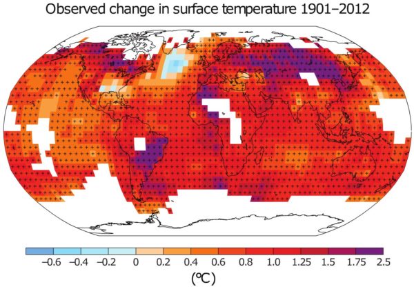

Samas Golfi hoovuse peatumise puhul ennustatakse ka Euroopale külmemat kliimat:
The weakening of the Gulf Stream might be tied to less heat reaching Northwest Europe, and more severe winter weather in that region.
This is mainly because of a slowing down of the part of the Gulf Stream feeding into the Atlantic Meridional Overturning Circulation (AMOC). Normally, as the Gulf Stream passes Great Britain, reaching the latitudes of Scandinavia and the Greenland and Norwegian Seas, the water cools and becomes denser. It then sinks, returning to the south at depths greater than 2000 meters, in what is referred to as North Atlantic Deep Water, the lower limb of AMOC. This sinking motion draws more warm Gulf Stream water toward Great Britain and Scandinavia.
Many models show that anthropogenic climate change induces a slowdown of AMOC, due to more precipitation and glacial melt in Norwegian and Greenland Seas. This addition of freshwater makes the surface water less dense, which makes it less prone to sinking into the deep ocean. If that’s right — if we get a slowdown of the sinking in the North Atlantic — then less of the Gulf Stream is going to turn northward toward Northwestern Europe. If AMOC and the Gulf Stream do become weaker, the probability is that Northwest Europe is going to get cooler, or not warm as much as it otherwise would under global anthropogenic climate change.
