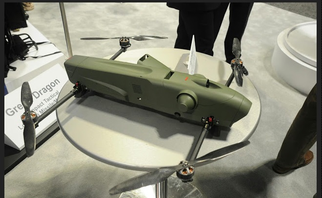

Viiskümmend kirjutas:Droonidele pakutakse täna ka sellist väikest aga suht nupukat lisaseadet (mida ka meie kohalik tööstus võiks teha) nagu käsigranaadi hoidik/päästik, ehk vana hea heitmise asemel viid granaadi drooniga oma sihtmärgi peakohale ja vajutad nuppu .
Juudid müütavad suisa KAHTE granaati kandvat UAV-d.
IAI says the typical range is 1,500 m, the maximum range 10,000 m with a 1 kg warhead. Actually the warhead is two handgrenades, to keep the system simple. The warhead compartment can easily switched with a second battery pack, to expand the flight time from 30 minutes to over 45 minutes for pure ISR missions. ROTEM L is a suicide vehicle, that can return and be reused as long as you don’t want to use the warhead.
http://www.miltechmag.com/2016/05/sofic ... ering.html

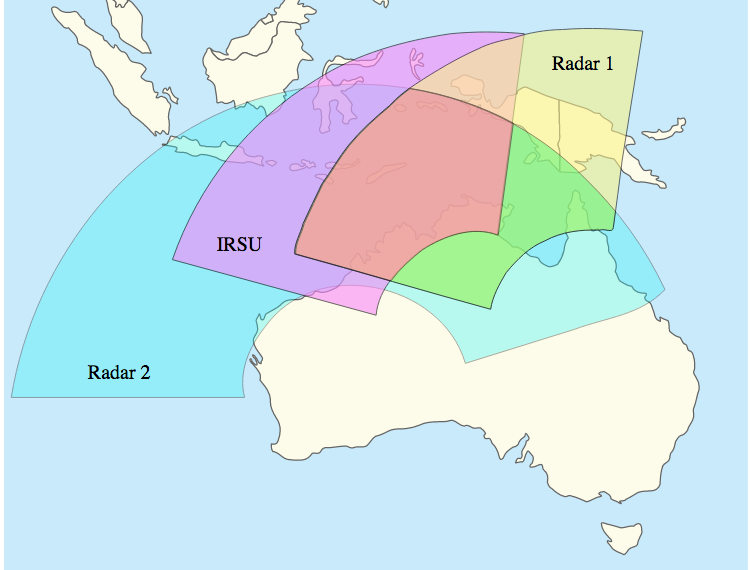

hornetfinn kirjutas:That link is about a study done about significance of stealth technology in the future. The study did concentrate on differences of 4th gen and 5th gen fighters as seen by MIMO radars. The study was done using computer simulations only but given the parties who did the study, the simulation was likely as good as it gets. The study itself is confidential, so it's not published but the summary does give some clues about the end results. It says that MIMO radar can offer improved detection/tracking probability against stealth fighter target and it was said that they got up to 30 percent improvement in tracking probability against stealth fighter using MIMO radars. It was however highly dependant on where exactly the transmitters and receivers were located and what flight path the target had. It was also found out that lower frequencies give longer detection range against stealth fighters, just as expected. It was also noted that having just detections or tracking by low frequency radar is not enough for air defences if stealth aircraft can not be engaged effectively. From the summary I get the feeling that 5th gen fighter still exhibits healthy advantage against 4th gen fighters even against MIMO and low frequency radars, although the advantage might not be nearly as large as against high frequency radars. It was noted also that computer simulations can not accurately take into account the effects of RAM and external weapons because simulations always have certain simplifications.
It was noted that additional studies will be done to support Finnish fighter acquisition process.
http://www.f-16.net/forum/viewtopic.php ... &start=150
Ehk tehti MIMO radarite simulatsioone 4. ja 5. generatsiooni hävitajate vastu (oma ala totaalsete tippude poolt). Nendes andis MIMO radar andis umbes 30% sihtimiskaugust juurde. Uuringute tegemine jätkub. Võrdluseks, et nullida 5. põlvkonna eelised oleks vajalik mitmekorde (vähemalt 4x), mitte mõnekümneprotsendine parendus. Ehk siis, hoolimata trollide püüdlustest näidata vastupidist, esmapilgul "hõbekuuli" vargsuse vastu ei paista. Igatahes mitte 10-15 aasta perspektiivis. (Ülla ülla, miks küll nii venelased kui hiinlased samuti varglennukeid välja aretavad).
Eriti toredad on kommentaarid, kuidas USA firmad justkui ei tea valda madalama lainepikkusega radarite teemat ja "ootamatud tehnoloogiad" nagu näiteks OTH radarid suudavad "vabalt tuvastada" varglennukeid. :roll: Huvitav küll, mis firma on Austraalias viimased 15 aastat seda over-the-horizon eelhoiatussüsteemi ehitanud ja täiendanud on:
Screen Shot 2016-05-26 at 19.13.16.png (95.59 KiB) Vaadatud 6806 korda
Ennäe Lockheed-Martin ... Ilmselgelt pole nad kogu selle aja jooksul kordagi tulnud mõtte peale antud tehnikat kasutada oma varghävitajate peal :D
