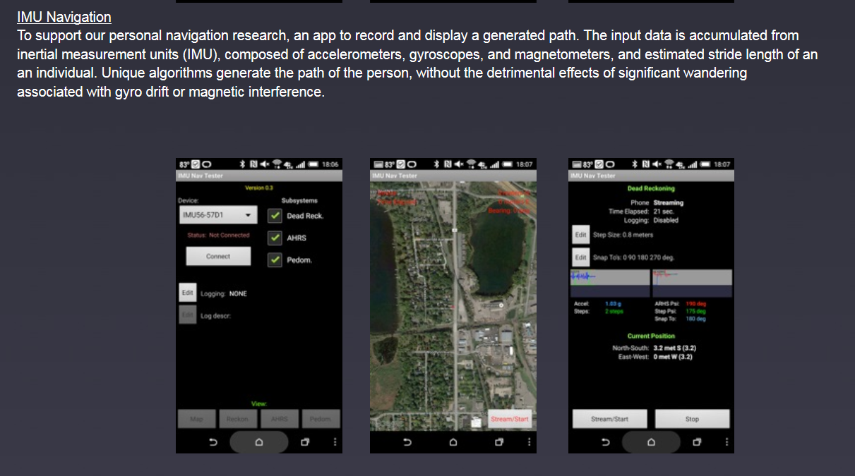

Mingi võimalus on vbl tulevikus kasutada laiatarbe nutiplutide ja naviseadmetega INS (Inertial Navigation System) meetodit ja vahendeid.
Positioning system for small devices using principles of inertial navigation system

Inertial Odometry on Handheld Smartphones
07.06.2018
Arno Solin Aalto University Espoo, Finland
Santiago Cortes Aalto University Espoo, Finland
Esa Rahtu Tampere Univ. of Tech. Tampere, Finland
Juho Kannala Aalto University Espoo, Finland
https://arxiv.org/pdf/1703.00154.pdf
Inertial sensors for smartphones navigation
https://www.ncbi.nlm.nih.gov/pmc/articles/PMC4695469/
