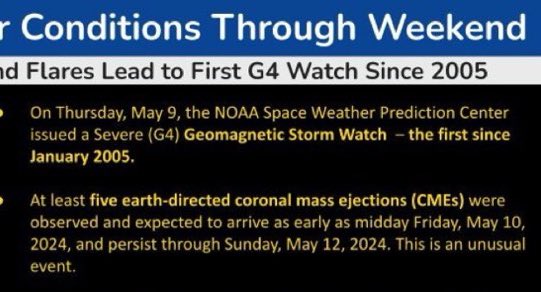

Nädalavahetusel läheb huvitavaks. Lisaks virmaliste mängule võib tulla elektroonikaga probleeme. GPS-i ja raadiosignaalide segamisele hakkab vahele segama suur päikesepurse(vähemalt 5 tk. toimus lühikese aja jooksul). Kohale jõuab umbes 1-2 ajal öösel meie aja järgi.
https://twitter.com/DrEricDing/status/1 ... 1871153535
INBOUND SOLAR STORMS—5x mega coronal mass ejections - CMEs - that can knock out power are going to be slamming at Earthbetween Friday and Sunday this weekend. Earth has only been hit with 3 previous severe CMEs in last 4 years. But we are gonna get 5x G4 CMEs in 3 days!
Let this sink — this is the first GEOMAGNETIC STORM WATCH since 2005!
Folks - this is serious - it can knock out not only electricity but it can theoretically knock out airplanestoo!
Folks- it’s possible. Not only can it cause higher radiation and knock out communications, but a strong CME can knock out airliner avionics. “according to reports by aviation regulators, the issue is not whether it will happen, but when”
that said this is a severe G4 “a category 4” CME storm, not the highest G5 “extreme” CME that was the infamous “Carrington Event” of 1859.
“The Carrington Event was category 5 or greater. So this is no Carrington Event. Even so, category 4 is pretty intense”.…
NOAA spokesman says that we won’t know the precise strength of each arriving CME until within **20-40 minutes** of each storm wave’s arrival (thanks to NASA space satellitespositioned 1 million miles ahead of each on the Earth-Sun path).
Reporter: “What is the worst case situation?”
NOAA spokesman: “TOUGH TO SAY, I DON’T WANT TO SPECULATE… WORST SITUATION WOULD LIKE 1859 CARRINGTON EVENT… We don’t want to discount G5 event, but possibly low level G5 possible. Likely G3-4”.
NOAA spokesman: “TIMING OF ARRIVAL 8PM EASTERN TONIGHT (approximately)”
Friday 8pm US ET.
“We need to know magneticfield - if the magnetic shock is same positive as North Pole, it won’t do much. But if opposite field, we will see effects”.
Hence hard to predict effects.
NPR reporter: “Can you explain how CME can affect Earth” “and how big?”
NOAA: “Sunspot 16x diameter of Earth. CME can affect magnetic field and induce electrical current (in our electrical systems)” (and hence overload electrical systems).
CHANCE OF ANOTHER CARRINGTON EVENT:
NOAA scientist spokesperson: “Hard to know. Our models say between 2-12%”

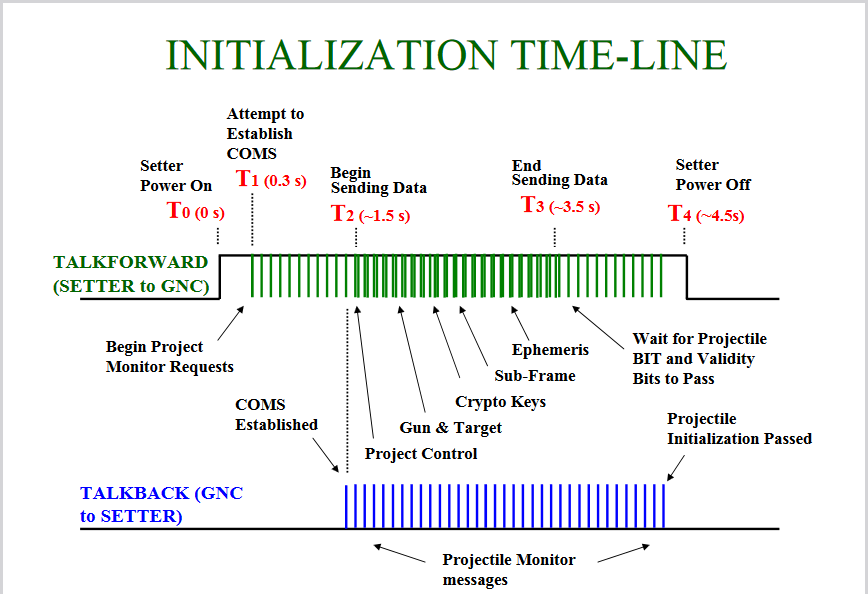

Juhitav moon vajab sihtmärgile jõudmise programmeerimiseks laskmiskohas:
* laskeseadme täpset asukohta (X;Y;Z koordinaate)
* sihtmärgi täpset asukohta (X;Y;Z koordinaate)
[algandmed, mis sisestatakse juhitavasse moona, et see saaks teha vastavaid arvutusi lennu ajal]
* algset välja arvutatud direktsiooninurka ja relva/laskeseadme suunamist selles suunas
* võimalik, et ilmastiku jms muutuvaid parameetreid (nt. tuulesuund ning tugevus).
* GPS MIL koodide (ja krüpteeritud P/Y ja M juurdepääsuparoolide/võtmete?) sisestamist
* veel midagi?
Teoreetiliselt (mina ei tea nüansse peensusteni) peaks tarkmoon juba laskeseadmes hakkama suhtlema sattidega (initsialiseerimine ja selleks kuluv aeg/vajaliku hulga sattide leidmine). Hiljemalt lasu/stardi hetkest alates ta igatahes seda tegema hakkab.
Edasi on kolm erinevat põhimõtet targa moona sihtmärgile juhtimiseks. Neid võib kasutada nii üksikult kui omavahel kombineeritult.
Põhimõtteliselt sisestatakse esmased andmed (ja tehakse initsialiseerimine?) ja siis kui moon stardib, tehakse kohe GPS initsialiseerimine kui enne pole tehtud, kogutakse muud algandmed (lennukiirus, pöörlemiskiirus, tõusunurk jne) ning tehakse vajalikud arvutused, et moon viia õigele lennutrajektoorile. Kui algandmed on valed (nt. lähtepunkti GPS koordinaadid X;Y;Z, valesti määratud põhjasuund ja direktsiooninurk, vale kiirus, vale kõrgus jne) siis arvutatakse moonale vale suund ja trajektoor. Mida kaugemal on sihtmärk seda rohkem lendab sellisel juhul moon sellest mööda + seda suurem tekib kas puudulend või ülelend.
Nüüd edasi oleneb juhtimispõhimõttest ja moona lennu suunakorrigeerimise edaspidisest vajadusest ning võimekusest.
Lisaks tuleb arvestada, et Excaliburil on ka mingi INS (inertsiaalnavi) võimekus mida saab kasutada ilma GPS toeta kui selle signaal kaob.
Osa andmeid arvutusteks tulevad pidevalt jooksvalt INS plokist ja need tulevad ka siis kui GPS signaali ei ole.
Edasi on kolm põhilist lennufaasi. Stardijärgne kiirenduse ja tippkiiruse saavutamise faas, tipufaas ja terminalifaas/lõppfaas.
Seega on GPS ja INS juhitav tarkmoon GPS jammimisele kõige haavatavam (jammimine avaldab lõpptulemusele kõige suuremat mõju) lennu algfaasis ja lennu lõppfassis. Kui jammimine/segamine toimub lennu keskmises faasis siis
a) algandmed on jätkuvalt õiged, välja on arvutatud õige direktsiooninurk, suund, teekond, trajektoor
b) keskmises faasis kadunud side GPS andmetega ei võimalda teha ülitäpseid asukohaparandusi (kui neid on vaja teha) lennu keskel, kuid moon liigub endiselt õiges suunas ja abiks on ka INS
c) lõppfaasis taastunud GPS andmeside võimaldab teha vajalikud täpisparandused ja korrigeerimised ning need jõutakse ka ellu viia, sest moon on liikunud kõigele vaatamata jämedalt võttes õiges suunas ja vajalik korrigeerimise suurus ei ole liiga suur ega ülejõu käiv.
Kui jammimine/segamine on algfaasis, siis on kõik arvutused valed, moon on viidud valele trajektoorile, valele kõrgusele, valele teekonnale, lendab vales suunas ja tekib lisaks kas puudulend või ülelend. Kui valedest algandmetest põhjustatud vead ei ole liiga suured ja hiljem mingis faasis taastub GPS side ning on võimalik moona asukohta täpselt määrata, tehakse uued arvutused ja siis suudab moon enda lendu vbl piisavalt hiljem korrigeerida, et ikkagi õigesse lõpp-punkti jõuda. Oleneb ka algtrajektoorist ja palju see erineb "tõelisest/õigest". Kui algvead on liiga suured ei suuda moon enam ennast õigele trajektoorile viia.
Kui jammimine on lõppfassis, siis algandmed on jätkuvalt õiged, välja on arvutatud õige direktsiooninurk, suund, teekond, trajektoor. Lennu keskmises faasis on saadud vajalikud täiendavad parandid lennu "peenhäälestamiseks" ja kui lõppfaasis kaobki GPS andmeside, siis INS hoiab kurssi mis oli arvutatud viimasel hetkel kui GPS andmed veel saadavad olid.
Seega teoreetiliselt on kõige hullemast variandist kõige parema variandini jammimise/signaalisegamise mõju järgmine:
https://ndiastorage.blob.core.usgovclou ... walker.pdfEXAMPLE 100 ms PIK TO PROJECTILE MESSAGE FRAME
• Sense when Time Mark Pulse (TMP) arrives
• Read Time Mark Message from GPS receiver
• Send Time Mark Message to Projectile
• Send Target and Gun data to Projectile
• Request a Status Message from Projectile
• Receive and Process the Projectile Status
